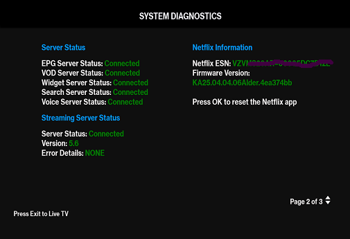

Which Fios boxes do you have? The new Fios One boxes or older ones? If the new ones are you watching on a mini or the main box? If it is a mini, is it wireless or coax or Ethernet connection? The Roku uses WiFi to provide your content through apps designed mostly by the content providers. The Fios box sends the data through Verizon's system directly, using an app. Did support have you go here and reset the Netflix authorization?
Main Menu > Settings > System Information>Press down arrow to page 2, then press OK to reset the Netflix app.

After some more research, it appears that there is a step to select "Info" that I needed to do and then arrow down to page 2 and select "OK".
I will see if that fixes my issues...

found this by CRobGauth:
Try this.
Go to menu - settings - system info
Hit info.
Use down arrow to second page.
It should say hit ok to reset netflix app.
Try that.
