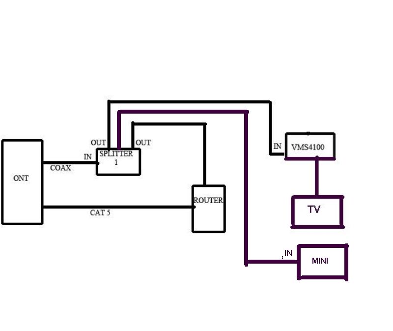

(3) One of my current cable boxes is nowhere near an Ethernet port (only coax). Which one of the two new boxes should be placed in that location? The Fios One TV or the Fios TV mini?
