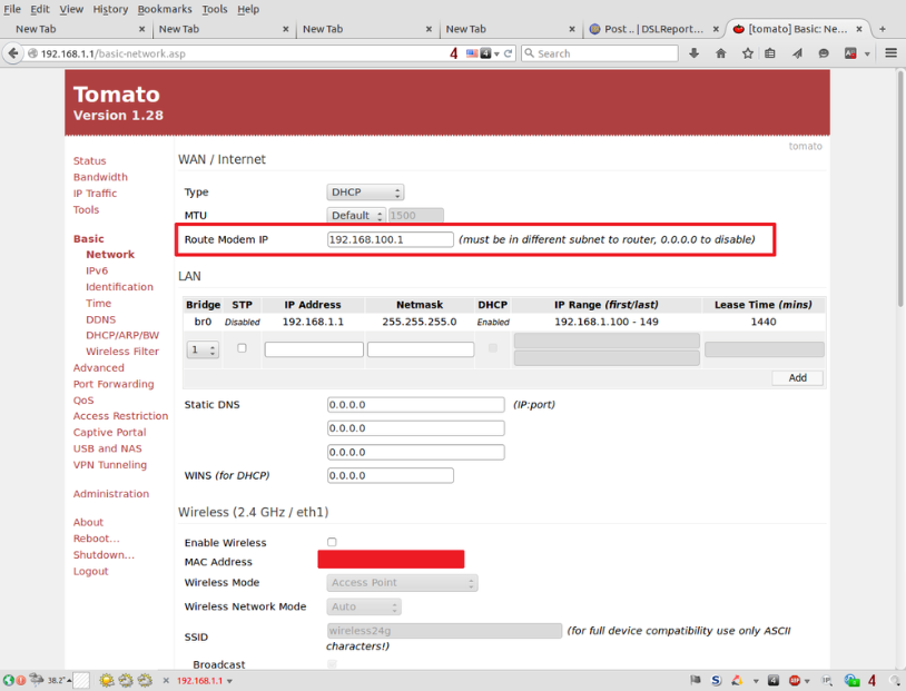

** Option #4 - Another Possible fix with access to both and online. **
#1 Both routers can not be in the same subnet.
#2 Using third party firmware (either with commands and then rebooting the router OR in the UI option of Route Modem IP field) on the router..
Note by commands and then rebooting the router, I mean - (Third party site) dd-wrt.com -> Community -> Wiki -> Tutorials (Basic and advanced configuration tasks for your router...
By UI option Route Modem IP, I mean with this..
While it is possible to do this with third party firmware, it is NOT limited/restricted to only third party firmware.
