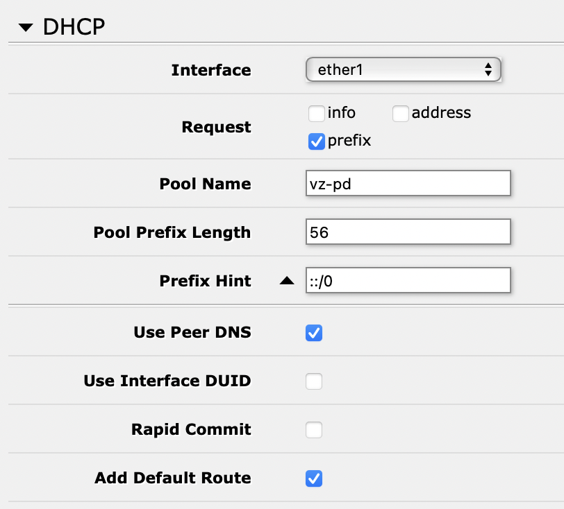

To request a /56 prefix, use DHCPv6 Client on WAN interface. Prefix length is 56.
DHCPv6 Client SettingDHCPv6 Client Setting

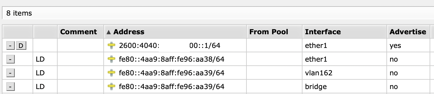

Strictly speaking, to route across networks, the router itself does not need a global unicast IPv6 address. Unless you need the router's WAN interface to be globally accessible, which has security ramifications. I choose 00::1/64 as the subnet for the WAN interface. You don't need such a large subnet, but whatever.
[TODO: there is a way to get a deterministic address as <prefix_from_56_pool>00::1/64

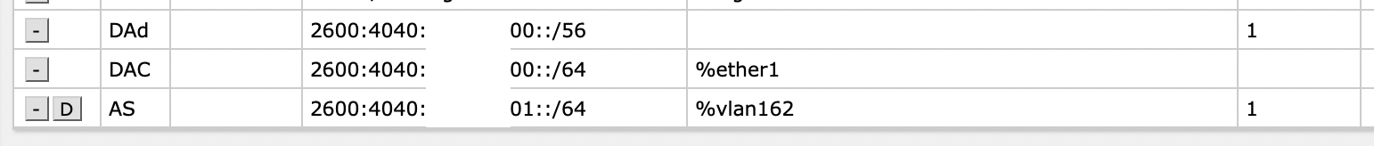

For internal networks, you can assign further /64 subnets to them. The distribution of addresses can be SLAAC or DHCPv6. For DHCPv6, there is currently no way to make a smaller /64 pool to dynamically reference the prefix of the larger /56 pool.
Directly Connected routes are automatically populated as expected.
IPv6 PoolsIPv6 Pools
