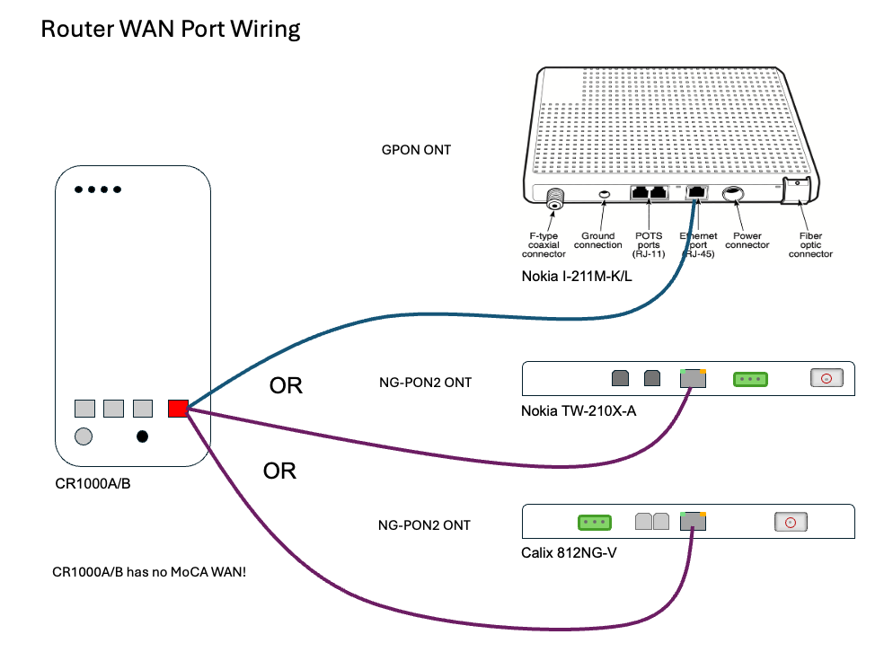

You need to make an Ethernet connection between the ONT and the Router. I tried to generalize for all popular PON deployments. For those with available speeds up to 1 Gbps, you have the GPON ONT, which is typically the Nokia I-211M-K/L. For those with available speeds up to 2Gbps, you have the NG-PON2 ONT, which is typically the Nokia TW-210X-A, or the Calix 812NG-V, which is paired with the E9-2 platform OLTs.

The Coax on the GPON ONT is usually not used for delivering the Internet, unless you have a speed tier lower than 100Mbps, which is rare. The Coax on the ONT may still deliver analog video for Fios TV services, if your area is still not upgraded to IPTV.
The Coax on the CR1000A/B cannot be used for a WAN connection. CR1000A/B, unlike the G3100/G1100, only has one MoCA chip tuned to the D band for MoCA LAN. The Coax can still be used for MoCA LAN, which can connect the DVR, Fios Stream TV MoCA Adapter, STBs, and other kinds of MoCA to Ethernet bridges.
Because Coaxial cables are shielded, according to NEC 800 chapters, one needs to ground the shielding. The GPON ONT has a grounding screw hole for this purpose. The Coax port is eliminated on NG-PON2 ONT for IPTV, so no more grounding requirements.
