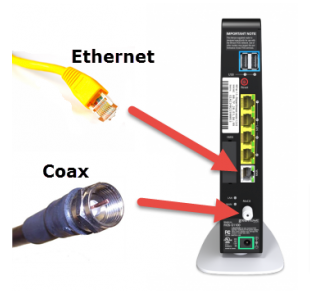

To use your own router, you need to have an Ethernet connection to plug it into. Almost all recent Verizon Fios installations are done using Ethernet. However, some older installations (mainly pre-2016) were installed using a technology called MoCA. To determine which type of installation is in your home or business, take a look at the existing router.
On the back of the router, you can identify which installation type is used in your home. Locate either a Coax cable, or an Ethernet cable (or both) in the back of your router as shown. Now with that information, read below.
If you see just a coax cable (with no Ethernet), then your installation is using MoCA to bring Internet to your house.

If you see an Ethernet cable going into the rear of your router, then no additional steps will need to be taken to connect the cable to your own router.
