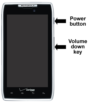

Press and hold the power and volume button for 10 seconds. It will reboot the phone.

Press and hold the power and volume DOWN button at the same time for 10+ seconds and it will reboot the phone.

Looks like we are... Have a Happy Memorial Day b33
Press and hold power button+volume down key until the device powers off then release.

Haha yes indeed B33. If you noticed my CAPS in my post, I just wanted to clarify that is it the DOWN button (which was missing from laniek's post). Enjoy the long holiday weekend!

worked for me....hold on/off and sound down at same time for 10 seconds....I had been using a sprint htc charger ....switched to the droid charger and working fine now............thanks for the info from here!
