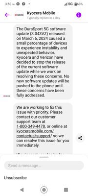

For those having problems with this still. Verizon is absolutely useless.
I got this from Kyocera and they are now aware of the issue. Call them to get a ticket open and await for them to call you back to get a replacement phone (on previous patch version), they said they are not going to push the patch anymore until this issue is dealt with.

And everyone else email Kyocera directly, a Verizon rep sent me this link through messenger
https://kyoceramobile.com/support/phone
I submitted a complaint with all of the troubleshooting steps I have already taken and they are now sending me a new phone with the previous software version on it. Kyocera and Verizon have chosen to pause the update until they have the bugs worked out. If you have any exception reports on your phone that have been generated since the update, be sure to attach them to the email. These will help them see where they screwed up the code. They claim it is only a small number of phones but I think only a small number of people have complained.

No we never received either call back. But thanks to posts on this topic I contacted Kyocera directly through email. They informed me that Verizon and Kyocera where aware of a problem with the update and had shut it off for the time being. But the update couldn't be removed so they would send us 2 replacement phones. I received them yesterday and all is working well so far no thanks to Verizon tech support.
