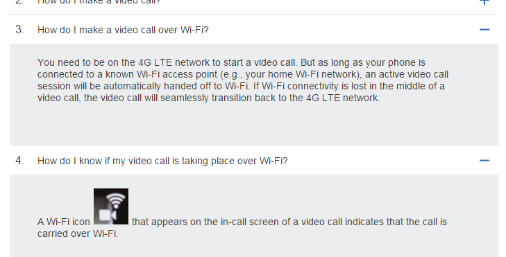

We performed several video test calls (each a few minutes in duration) while connected to wi-fi & neither of us noticed any icon/indicator to tell us that the video 'portion' of the call was taking place on wi-fi, as specified in the Advanced Calling FAQ (see #4 below):
In addition to there not being any icon/indicator as specified above, the wi-fi indicator in the Android system tray at the top of the screen didn't show any activity, while the 4G LTE indicator showed constant upload/download activity.
After ending the calls, I checked our mobile data usage on the phone & it showed 15-20MB for 'Video Call' under the Mobile data section & when I checked the Wi-Fi data section for 'Video Call' it said 0.00B (nada, zero, zilch), so it appears that the calls didn't get "handed off" to Wi-Fi as specified in the FAQ (see #3 above). I waited until the next day & then logged into my account online to view our Data usage... sure enough, Verizon's site showed chunks of mobile data being used at that same time as the calls, all while we were on Wi-Fi.

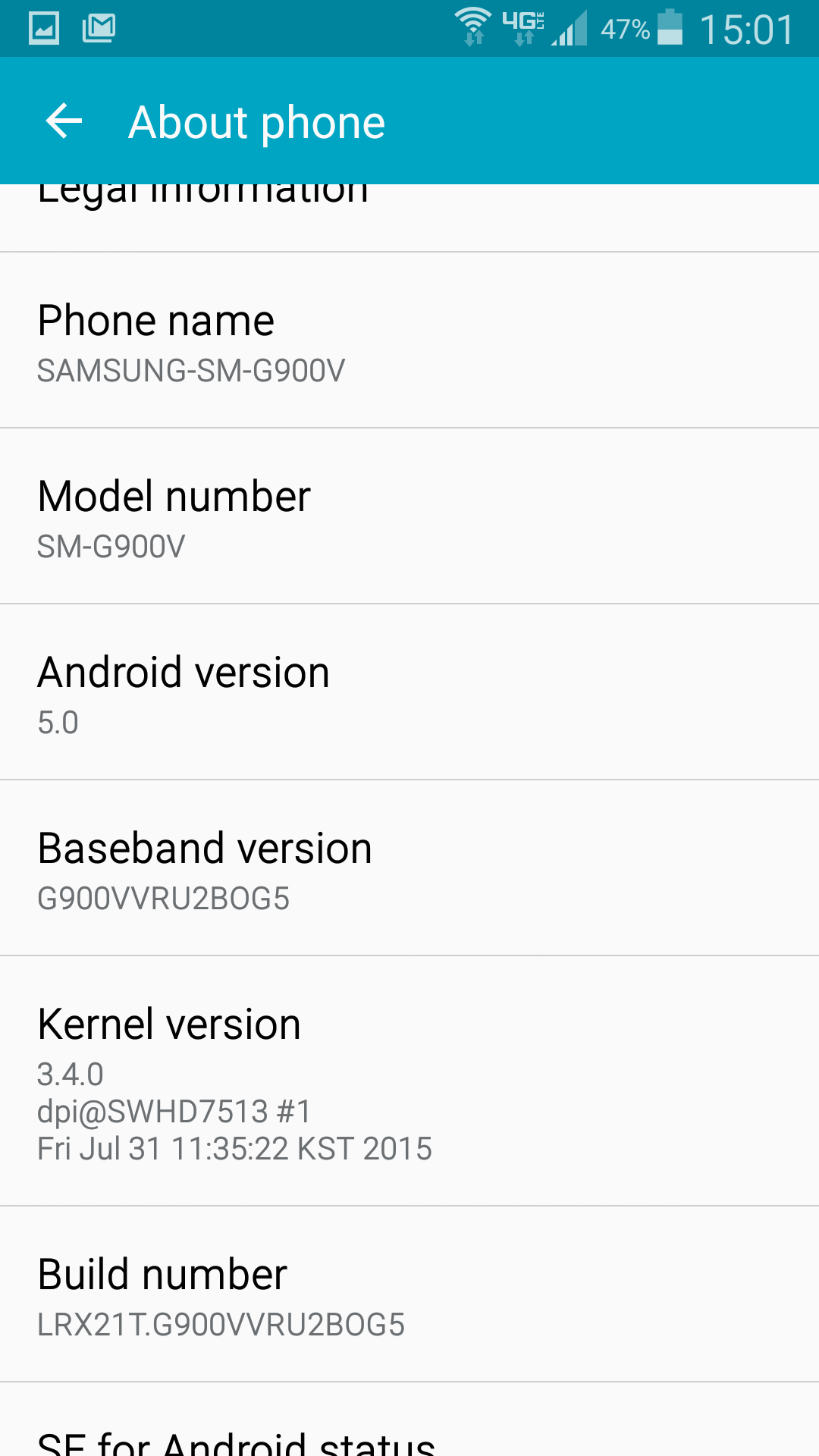

Yes. Below you will find a screenshot of my device's baseband, kernel version, & build number. My wife's S5 mirrors mine.
