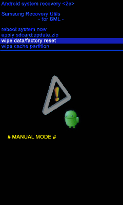

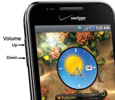

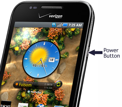

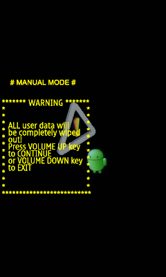

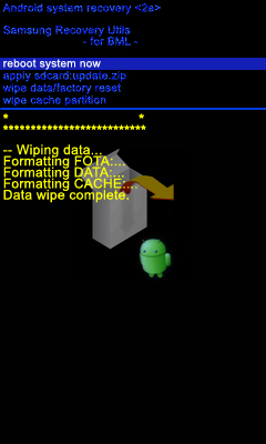

Have you tried wiping the cache of device (Step 1-4 below and select Clear Cache) and if that dont work do a hard reset by following full instructions...
Alternate method
- Press and hold the Power button.
If the device is non-responsive, remove then replace the battery. Refer to Battery Inserting / Removing for additional assistance.
- Select Power off.
- Press and hold the Volume Up / Down keys and the Power button simultaneously. When the Samsung logo appears, release only the Power button.
- From the Recovery screen, press the Volume down key to select wipe data / factory reset.
- Select Home.
- Select Volume Up to continue.
Allow the factory reset process to complete (approximately 1 minute).
- Ensure reboot system now is selected.
- Select Home.
- Refer to Initial Activation and Setup.
