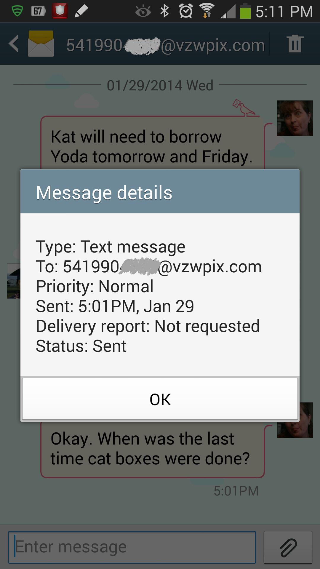

Here you go, it's just started happening AGAIN, this time with my other daughter. The original text, sent at 4:59 pm, went by regular text message. The reply went to the vzwpix.com address. I'm attaching screen shots (don't giggle at the obvious mom texts).

It did not work. I cleared the cached, deleted all messages, went to text my daughter again and it immediately came up as 541990xxxx@vzwpix.com

Cleared all contact info out of my contacts.
Deleted all text messages.
Cleared message cache.
Cleared out contact cache.
For good measure, deleted anything with my daughter's phone number out of gmail as well.
Went to text her manually and this came up:

It has been solved. Even though I had scrolled through my contacts and the phone number in question did not show, per Elector's advice, I did a search for the vtext.com and found it, erased it and it is now working correctly. This has been maddening and I can't understand how resetting the phone to factory would fix it until it chose another number to do that to, but whatever the case, it is fixed and not driving me batty anymore.
