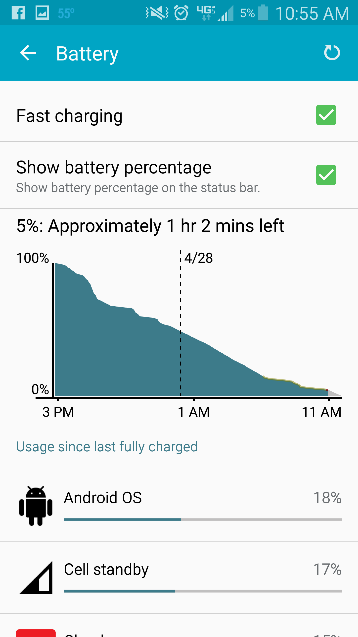

After installing the lollipop upgrade last weekend, I notice via OS Monitor app that the kswapd0 system memory swapping app is running constantly with anywhere from 5-25% CPU. When the developer option "flash on long operation" is enabled, the red flash can be seen constantly every few seconds even when no apps are running and the device is sitting on the homescreen. This never happened under 4.4.4. My rate of battery use has increased significantly -- previously, I could get 8 hrs on a charge with normal use, now only 5-6 hours. GSam Battery App reports around 20-25%/hr use; previously under 4.4.4 it was 15%.
Additionally, a serious issue is that occasionally the device does not recognize the Fast Charger is plugged in -- it goes into USB Charge mode, which sometimes is insufficient to provide enough charge to avoid running down the battery when the swapping is too high! This happens even when it is completely powered down - it will not charge properly for some time. Eventually, it goes back to normal and resumes fast charging.
I have wiped the system cache (several times), but I prefer strongly to avoid factory reset (and not sure that will actually improve the swapping issue, anyhow). I wish I had not upgraded to 4.4.4, and hope that Verizon will quickly provide a patch for these problems.

This issue was finally fixed by the VRU2BOK3 5.1.1 update. No factory reset was ever performed or needed. The phone performs great again, with less battery use and reduced lag. I blame a combination of Google (the system bugs) and Verizon (took how long to deploy?) for the fiasco.

based on some additional research and some advice from xda forums, the battery burn seems to have something in particular to do with sd card usage in lollipop, or especially having installed some apps to the sd card (which I have in kitkat).. I wonder if the folks who report having no issues are NOT using sd cards? I tried moving the apps back to the main device, but it seems like it still uses some aspect of the sd card for now and thus I remain still having excess battery usage unless I attempt to factory reset (which I am still refraining from, as that is not really clear whether it will 100% improve the problem anyhow). I will attempt to experiment with safe mode for an extended period and see if there's any improvement (although it doesn't seem really a fair test since most of my apps will not be available in that mode).

Update - I tried removing the sd card for a few days, but it made no noticeable difference in battery usage performance. Overall battery usage is still noticeably worse than KitKat. Based on all the reports about poor S6 battery life, I suspect it is just a Lollipop issue in general!

testing in safe mode for a couple of hours
- battery usage is somewhat better, but not dramatically so
- safe mode isn't very useful (as most apps aren't available), nor safe (as some non-internal apps come up anyhow via notification - can't access them directly from the home screen, but can bring them to the front by clicking the notification and then switch back via the app switcher)
- most apps aren't running, so it's not really a very interesting test anyhow. the main point still being that we never had any battery issues under kitkat even with all apps running.
