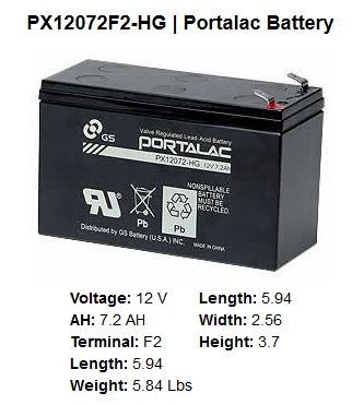

1) There are many brands that will work. Here is the battery provided by Verizon in my Battery Backup Unit (BBU):
I have no way to know whether the same battery configuration will work in all BBUs, but this one is in my BBU for a Tellabs 1600-612 SFU Optical Network Terminal (ONT).
2) The important battery characteristics are:
a) Size, it needs to fit in the BBU.
b) Voltage (12 volts)
c) Terminal type (F2 in this case)
d) Rating in Ampere Hours (7.2 in this case). 7.2 should be the minimum for any battery you buy, higher won't hurt and will extend the run time slightly.
Certainly Amazon is a respected and reliable source. But if it were me, I would look around locally to see if I could find a new battery faster, and maybe even cheaper. And if you think you do find one locally, I highly recommend you take the old battery out of the BBU and carry it with you to make sure the new battery will fit and has the same terminal arrangement.
