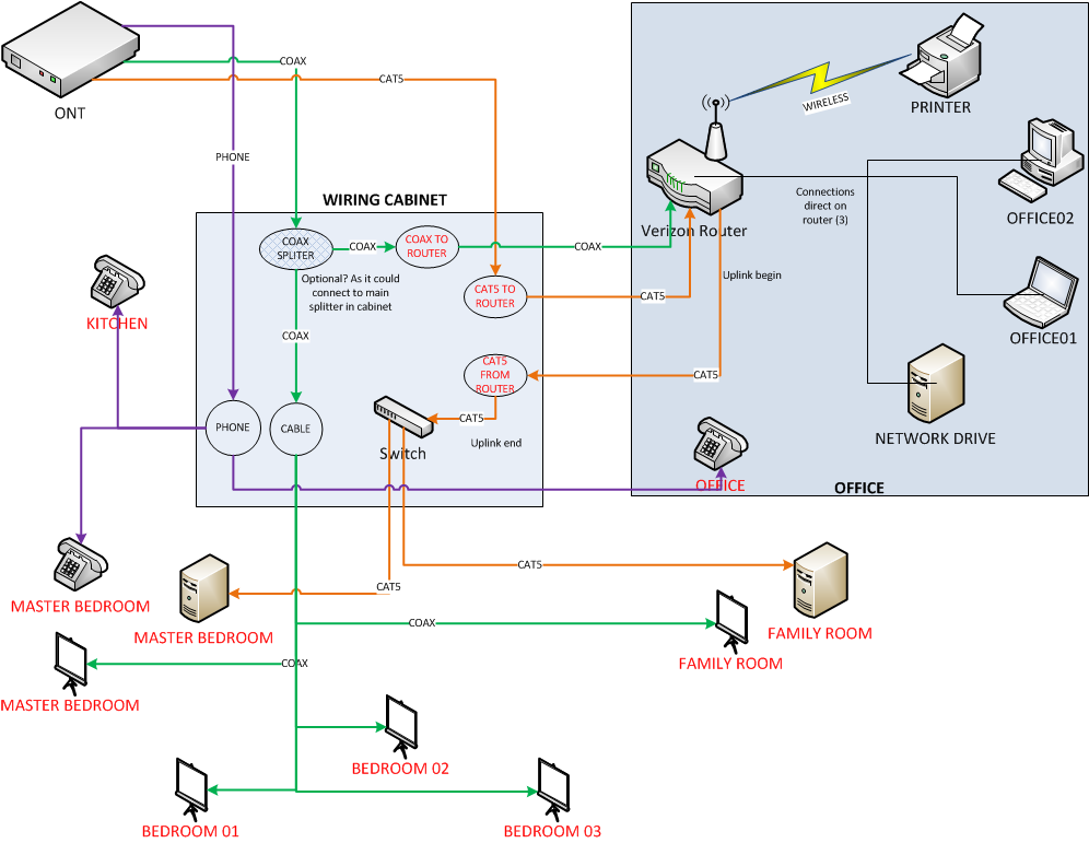

We are building a new home and as part of the package, I have been given the option of setting up 12 ports (phone, data, cable) as well as any additional ports I would want to add for extra. I currently have Verizon FIOS service for PHONE, TV and INTERNET. I have been reading several posts where it is stated that if I have both TV and INTERNET, then I need to make sure my router has incomming COAX and CAT5 lines. One additional requirement is that the wiring cabinet will be placed in the basement, however, I want to have the router located in the office room to ensure I can leverage the wireless adapter.
Based on my desire to have the router placed in a room separate from the wiring cabinet, I wanted to get feedback from the community as if my assumptions are correct for my selections.
I selected to add 2 CAT5 ports and 1 COAX port to the office room. The COAX port will handle the TV needs for the FIOS TV service. For the 2 CAT5 ports, I have listed one port which will be an incomming Ethernet connection comming from the ONT via the wiring cabinet and will be connected to the WAN port in the router. The second CAT5 ethernet connection will go from one of the LAN ports and go down to the wiring cabinet so it can be connected to a switch to distribute the internet to the rest of the ethernet ports in the home.
A picture of the overall topology is listed below. Have I covered everything I needed to be able to have the router separate from the wiring cabinet? Please let me know any suggestions or advice.
