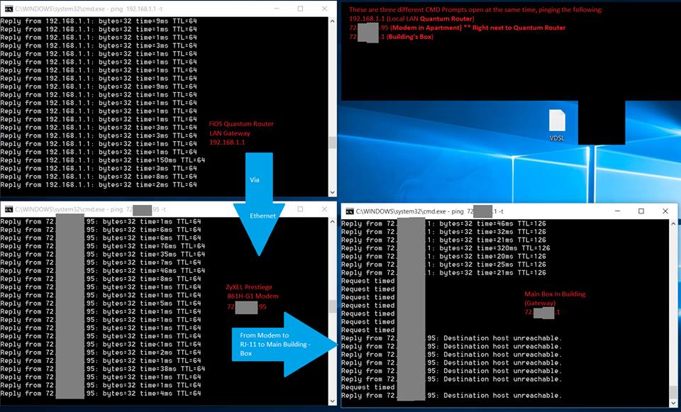

We are now experiencing the same problem again. The internet will randomly drop out every 1-2 minutes. I opened up 3 command prompts with my ethernet cord from my computer directly hooked into the router and had a continous ping test running on the following

It seems that this second modem can't keep a connection with the main building box on the VDSL line in the building.
I performed this test mutliple times wirelessly, wired, different ethernet cords while wired, on all of our devices in the house AND directly plugged into the modem. I am still getting the same issue. 72.xx.xx.1 (main building box) cannot be reached. In the bottom right command prompt while pinging the main building box it will drop out with "Request Timed Out" and then 71.xx.xx.95 (my modem) will send back a response for me in this window with "Destination Host uncreachable."
