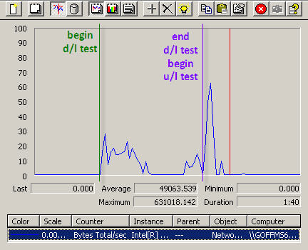

For the past week (maybe two), I've had severely reduced download speeds. I'm on a 15/5 plan and speedtest.net shows that I'm getting between 500kbps and 1Mpbs down, but ~5Mbps up (normal) and pings in the 35-45ms range to a server ~100 mi away (pingtest.net shows grade A too). The download rate chart shows that b/w varies a lot during the download.
This is confirmed with perfmon (unfortunately limited to 1 sec resolution). In general, the test starts off strong with a few ticks @ near full bandwidth, then drops to practically nothing. Perfmon sample resolution is too short to get the full b/w, so every d/l sample is showing lower than u/l in the below.
Performance tests done on verizon.net/speedtest show normal (which isn't helping me convice L1 to escalate me). Since pings are fine in the above tests, tracert doesn't show anything interesting.
