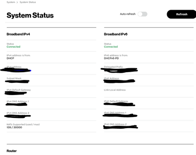

You can also login to the router https://192.168.0.1 go to System Status and it'll show your LTE and 5G signal strength

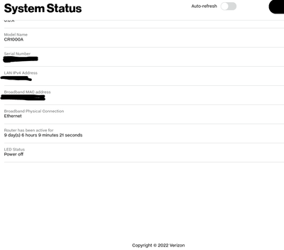

Interesting my system status (Basic or Advanced), https://192.168.1.1/#/adv/system/status just shows connected IPv4/IPv6 and router details. Can you paste the link just in case I'm looking at the wrong page?
Thanks

That's the correct page - did you scroll down farther down?
I wouldn't suggest a mobile browser, I almost always use a PC.
You should see -
4G LTE Signal Strength
-91.0
5G Signal Strength
-116.0

I'm on a PC and have looked at the entire page

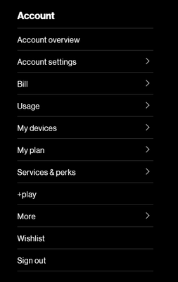

Funny as I feel like I have some weird one-off account. When I sign into https://www.verizon.com under account I have
When I click around it seems My Devices is the page I need to get to but The Networks and Devices Tab is greyed out so I'm back to my initial post. The service works fine, but the website and app seems to be buggy for me.

How do you get to this on the app. The option seems to have disappeared once the internet was setup. Do you have special privileges on the app or website because we seem to be having a different user experience.

This is essentially the same KB article I posted in the original thread. If I assess this via the website or the app, those options are greyed out or not accessible. When I sign in on the router, I use the password on the back of the router. For the app or website I sign in under my account and appear to be an account owner or manager because I have all the billing and payment rights listed here, https://secure.verizon.com/account/roleInfo/start
Maybe I'll call verizon to see if there's anything about my account that hasn't been setup correctly.
