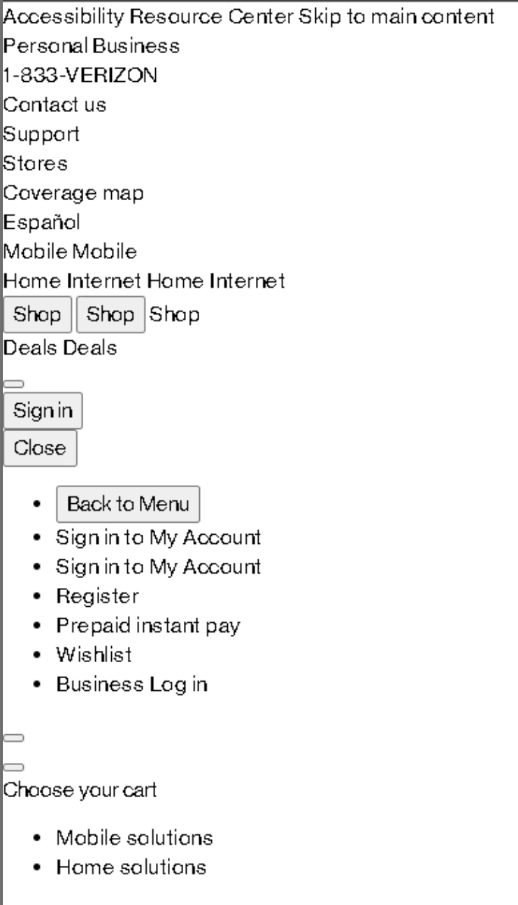

I recently started having speed issues with loading pages, speed tests were okay but pages resolved very slowly. In an effort to fix this I switched to IP passthru because my linksys router was always awesome before I got Verizon Home Internet. Speed seemed better but any page I try to go to that requires a login seems to either not load or loads with just text, like certain content is not accessible. See screenshot. Running out of ideas, any setup I try does not seem to bring the service back to what it once was. Has the service just become too congested in my area???
