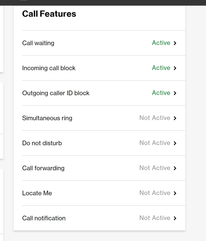

Not the case unfortunately. See screenshots below. Incoming call block settings included just to show it is on for anonymous calls only. I've tried turning it off, it didn't change anything. Thanks

The images will appear once a Moderator checks them out.
