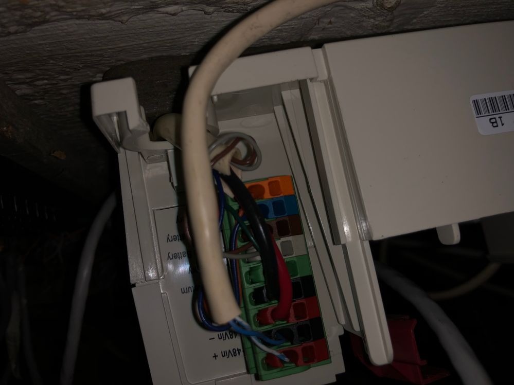

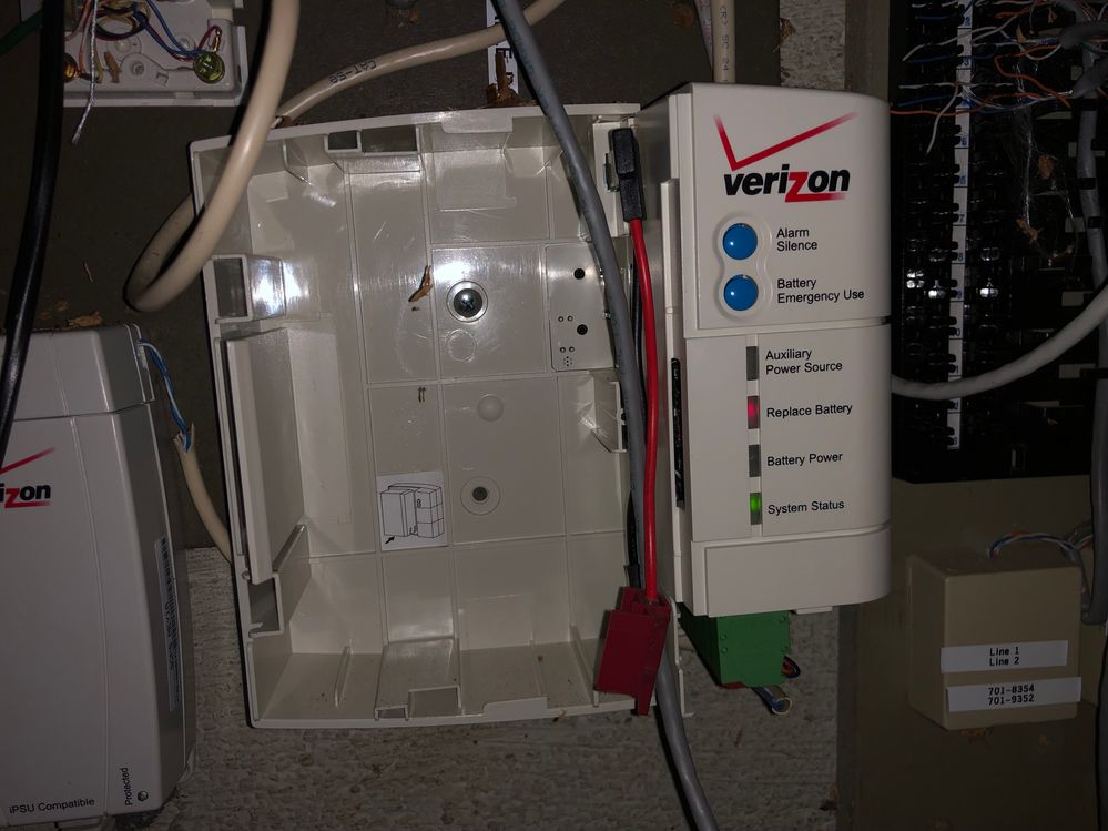

Here are two pictures of the inside unit. Is this unit being used for anything now? I assume the coax going to the Quantum router is going straight to the ONT? I don't have phone or TV service. It would be nice to unplug this as it has a big wall unit that I am sure is sucking some power.
There is one cable coming from outside to this unit. It is an odd one - a thick bland and red cable and some smaller coulored cables.

Yes that is the BBU/power supply. That is powering up the Outside ONT. The red/black wires are power and the colored smaller wires are the signal wires that communicate with ONT. You will have to run your ethernet from the outside box to your router.
