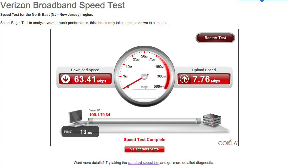

I've checked several times during the last month, using various tools including the one provided by Verizon: http://speedtest.verizon.com/fios300/#
My connection speed is often extremely slow, while my account is supposed to be 150 Mbps/65 Mbps, the experience sucks (YouTube, Netflix, Hulu, etc. buffers a lot), even sites are often slow to load. The Verizon tool shows 40-65 Mbps Download and 7-40 Mbps Upload!
Here's an screen shot of a recent test:

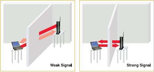

- Have the router elevated to the height of where the PC's Sit. That means if your PC is on a desk, have your router sitting at that same height.
- Experiment with the router standing upright or laying flat.
- Adjust the antenna's

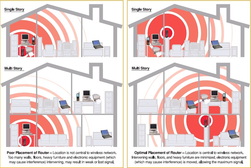

- Try to place the router in the most central spot you can (pictures below will help explain what I mean)

Also take a look at page 2 of Actiontec's Wireless PDF File. It gives you some idea's with regards to position and orientation of where the router sits and how it can best be positioned for maximum coverage.
http://support.actiontec.com/doc_files/MI424WR_Rev(all)_Wireless_Networking_Guide.pdf

Thank you for the detailed response.
Unfortunately, the problem is not with the wireless network, as I get the same exact results when I'm connected to the router using a wire. I've also tested while having only one device connected, same results.
This seems like an issue with Verizon itself, the connection fluctuates all the time.

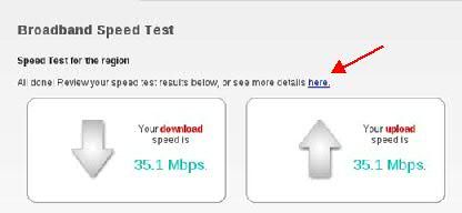

..,.speed test even says I amm getting 24+ mbps but I can't even watch youtube videos without having to pause them for them to load?.
it took 4 seconds to load this page.
Speed test is a sham.
