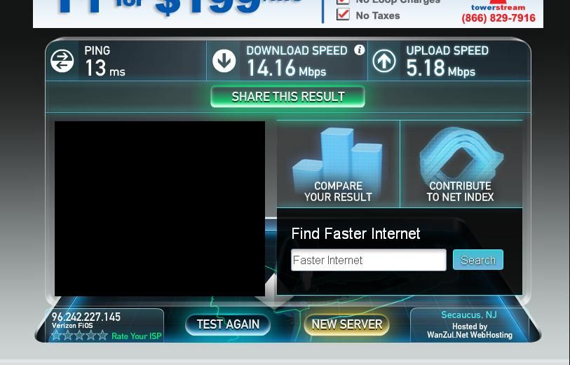

Our Network techs advse to do this "pathping www.yahoo.com this command will do a tracert to yahoo, and then ping each hop 100 times. If there is packet loss, it will tell us which segment is affected"
Please keep us posted, also can you please post a screenshot of a speedtest?
^MMP
Reply
Anonymous
Not applicable
That is the speedtest result.  The pathping hangs so can't really post the result on that.

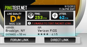

dpmalito99
Newbie
i am having this issue now too!!
OMG this is horrible! I cannot believe it! IUp until about two days ago my pings were great! Best ive ever had!
Now I get 350-250 pings and I cannot play ANY ONLINE GAMES.. What the heck Verzion?
This is obviously not mine or the other guy's fault since it now is confirmed to happen two multiple users!
I REALLY hope someone follows up with me at my email {edited for privacy}
I need to solve this or I have no choice but to cancel V FIOS for not providing the internet service they promised. Shame, too, cause its been so great till now, and i was even thinking of  going up a speed tier! NOt with 350 pings, though.
Here is my yahoo ping from tonight, 730pm, its horrible.
dans-mac-mini:~ macmini$ ping www.yahoo.com
PING ds-any-fp3-real.wa1.b.yahoo.com (98.139.183.24): 56 data bytes
64 bytes from 98.139.183.24: icmp_seq=0 ttl=50 time=245.099 ms
64 bytes from 98.139.183.24: icmp_seq=1 ttl=50 time=259.619 ms
64 bytes from 98.139.183.24: icmp_seq=2 ttl=50 time=279.811 ms
64 bytes from 98.139.183.24: icmp_seq=3 ttl=49 time=281.032 ms
64 bytes from 98.139.183.24: icmp_seq=4 ttl=50 time=336.200 ms
64 bytes from 98.139.183.24: icmp_seq=5 ttl=50 time=284.526 ms
64 bytes from 98.139.183.24: icmp_seq=6 ttl=49 time=283.881 ms
64 bytes from 98.139.183.24: icmp_seq=7 ttl=49 time=372.759 ms
64 bytes from 98.139.183.24: icmp_seq=8 ttl=49 time=407.806 ms

here is my pingtest image
here is a clue, though.. if i restart my router, for the first minute or so, the ping is regular, 30 ms about.
its as if verizon fios is throttling me.. I HAVE been downloading a ton of big movies lately, but that shouldnt throttle me,, right FIOS?>

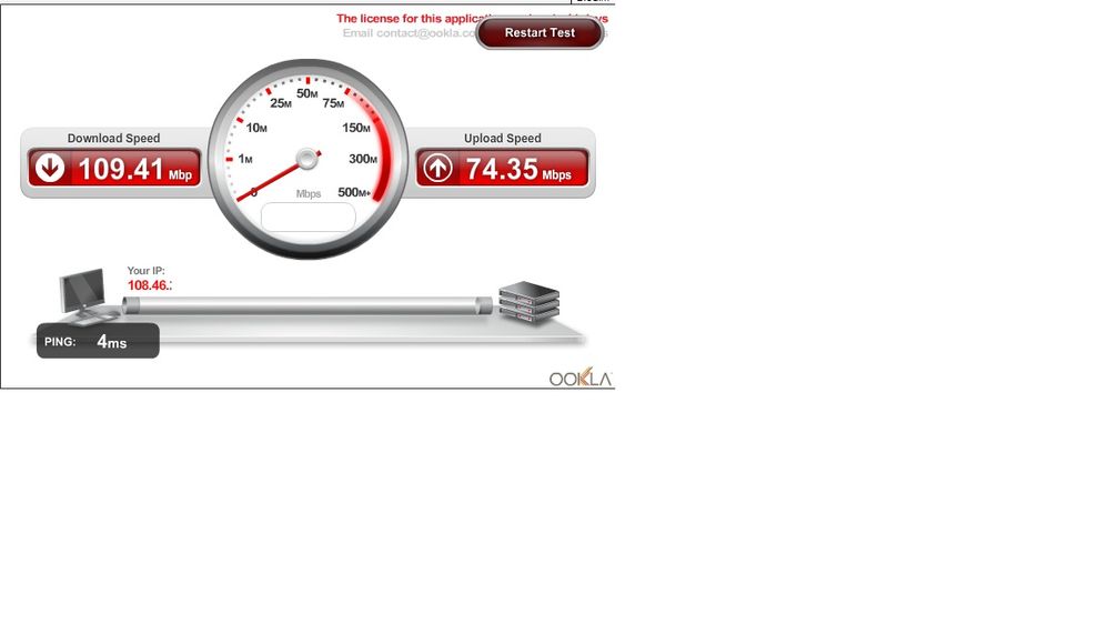

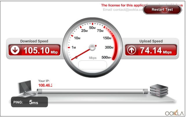

I have the Quantum 150/65 service here in Brooklyn, NYC and I get the same slow down/ping issues.
pathping

NYC towerstream
http://www.speedtest.net/result/2183833080.png
Secaucus Jersey
http://www.speedtest.net/result/2183834468.png
VZ-NY
VZ-NJ
