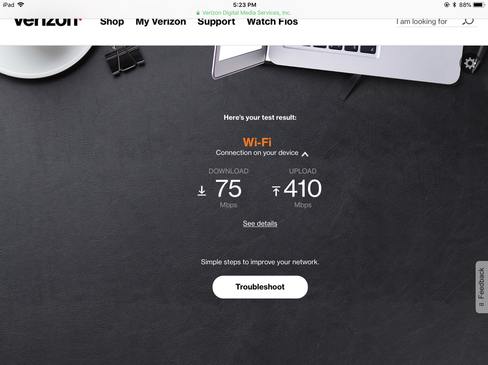

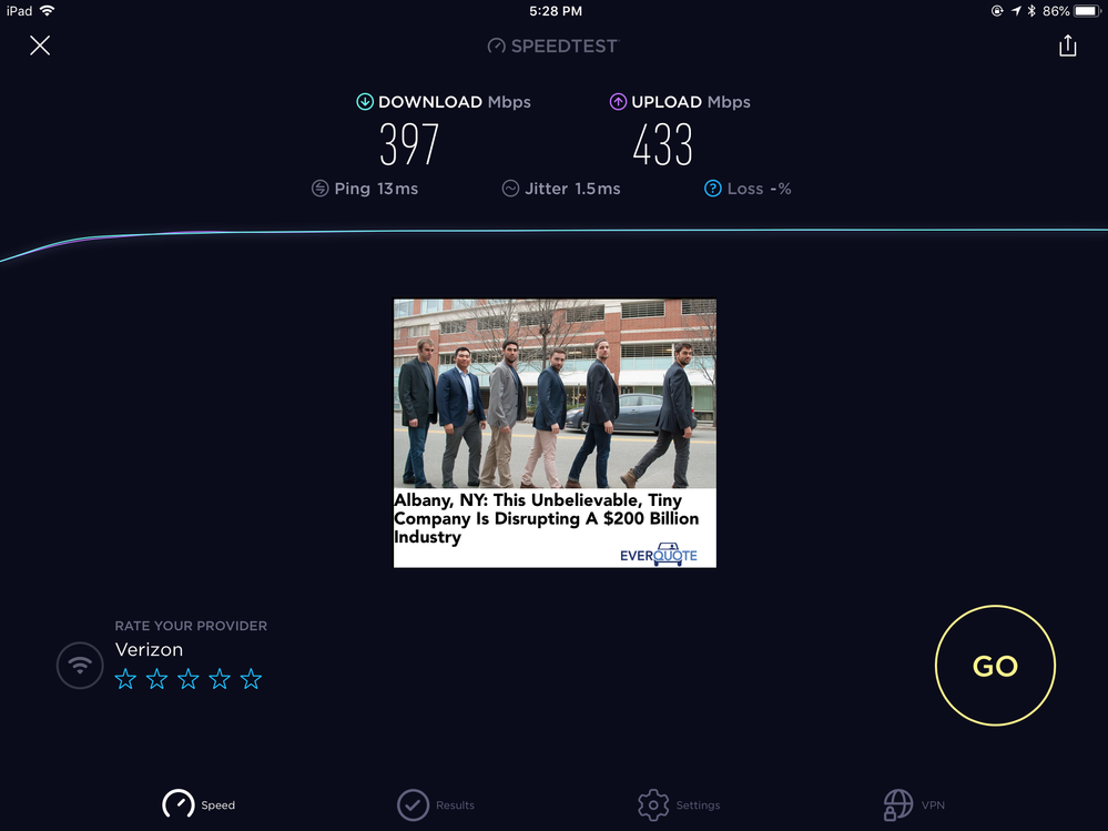

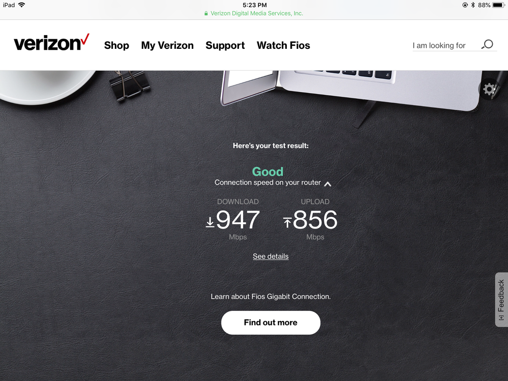

Here is my speed tests using both a Fios Quantum Gateway G1100
i had to hook it in instead of my Nighthawk R8500 which cannot use verizons test site.
Router to Fios server
Apple iPad 4 mini device test.
As you can see big difference in results. This is my WiFi from my Nighthawk using Ookla
WiFi speed test from iPad 4 mini using Nighthawk
