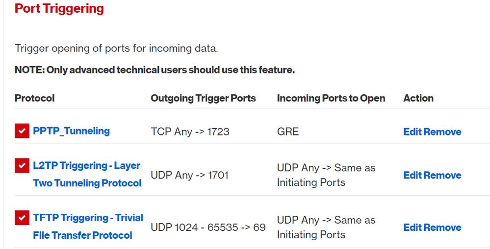

GRE is a layer 3 protocol, same level as TCP so you cannot port forward a specific port for GRE.
You need to configure the G3100 for port triggering (not just port forwarding). The incoming port is TCP 1723 then triggers the router to open GRE protocol.

Outgoing Trigger Ports should take care of the port forwarding.

Unfortunately, after putting in the port trigger and rebooting the router, I still get kicked off of the internet as soon as I try to connect to the VPN. I have confirmed that the VPN is in fact PPTP by connecting to it from another location and checking in network settings, so I'm surprised it still isn't working. Any other ideas would be much appreciated.
