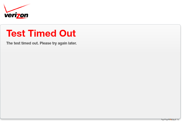

-Speed tests consistently time out or give me upload results of <3Mbps (usually <1Mbps)

Speed tests to other servers in the area (DC, Reston, Ashburn) all result in the same low speeds.

01/12 - They send a technician out to check and he took everything off the router and plugged in his Verizon laptop. I overheard him speaking with someone (at the CO?) and that some of his attempts to run the Speedtest timed out. I didn't hover over his shoulder while he worked but he swapped the router out with another Rev. I he had in his truck and cleaned the fiber.

I left a Steam chat window open and see that I've lost connection/reconnected to Steam ~4 times in the last hour. I'd give Verizon the benefit of the doubt as Steam servers do act up but if it's happening to XBox Live too it points to being a Verizon issue.
Here are a few today at 8:33PM, 8:41PM, and 8:44PM EST
