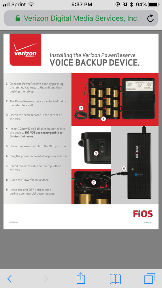

Okay great. So nothing needed to do at the ONT. To disconnect the power d cell tray just take out the wire labeled #6 in that picture. Then take the plug from the power adapter that's in the electrical outlet and put it into the UPS then plug the UPS into the electric outlet. Take your 12v lead acid and put it in you UPS and that's it. When power goes out your UPS will kick in and your ONT will be on battery backup.

There’s a power cable running from the battery-pack to the ONT. I just looked at the battery-pack. I hoped that I could disconnect the battery-pack from the ONT at the battery-pack but I can’t. There’s no way. There’s only one connection from the battery-pack to the ONT. I can only disconnect the battery-pack from the ONT & I can’t get the ONT door open. Unless I can get the ONT door open, I’ll need to keep the battery-pack turned off. I want to disconnect the battery-pack from the ONT so that I can take the battery-pack to the Verizon store. I still have the box that it came in. Why is the ONT door so hard to open? I pulled on both latches but the door won’t open.
