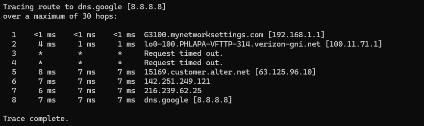

Many websites are taking 2 or 3 tries to resolve and come up. My cloud backup is failing on average 4 nights out of 7 and asks me to check if I have a bad internet connection. I have Fios gigabyte internet service and Fios speed test takes about double the time it used to when run but says I have close to 1gig speed up and down. I have spent over 5 hours with chat support in multiple sessions starting 5 days ago, and almost every time they disconnect the router to work on it, I lose the session and have to start over. Links they send to my cell phone never arrive so I can't start the chat from there. They have changed my IP address, flushed my dns cache, rebooted everything (router, ONT) multiple times. When I run a trace route, it gets to philadelphia, then times out twice in their network, then chooses an alternate IP address and it does ultimately get there. It has timed out every time I've tried it (at least 20 tries) in Philadelphia. I suspect the timeout is causing the issues. Below is a pic of a recent trace.
I suspect this is an error in their network or with their dns server. Is anyone else in the new castle county Delaware or philadelphia area having this issue or figured out how to resolve it?

The traceroute looks fine, and is quite clean. Nice steady latency with no packet loss. Those timeouts are coming from routers on the Internet which are simply choosing not to respond to ICMP and Traceroute requests.
If you're having issues with the Internet dropping out, does your router ever give an indication that the Internet is down? For example, a red status light or log entries saying "WAN is down."
Another possibility could be with IPv6. Try temporarily disabling it on your PC to see if the Internet performance improves. Some network cards in the past were found to have trouble while on the Fios network with IPv6 traffic. See this article on how to turn off (or turn on) IPv6: https://www.itechguides.com/disable-ipv6-windows-10/ . The steps should be the same for Windows 10 and Windows 11.

Hovering over the internet Icon on my computer says "internet access". IPV6 was already off. Another party in this thread has responded they were having similar issues and that pingplotter indicated many lost packets. I have downloaded and installed pingplotter sidekick and will see what that says.
