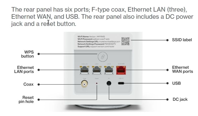

My old Fios router died and Verizon replaced it with a new model. The new router has no coax connection, only Ethernet. The new router is working fine for internet and WiFi connections.
Now, a few days after the upgrade, I have no guide for Fios TV. Obviously I can't reconnect the coax to the new router (model CR1000A) since it has no such connection.
My STB is a few years old. It's a Motorola QIP7232 2. Is there any way to get the guide information to this STB from the new router? For example, can it be connected over WiFi for this function? Or will I need to get a new STB as well?

Look here at Page 9 for a picture of what the back of your router should look like. There SHOULD be a coax connector on the lower back of the unit:
https://scache.vzw.com/dam/support/pdf/user_guide/cr1000a-verizon-router-user-guide.pdf

Oh man, what a "Doh!" moment. I must have looked at that thing half a dozen times without noticing the coax jack.
In my defense, when I reported the dead router, the Verizon tech said something about the new one not using coax. I jumped to a conclusion. You see what you expect to see, I guess.
Anyhow, thanks. All good now.

You were close, I believe the new 5G based routers do not use a coax connection any more. Hopefully once you get that coax hooked back up you'll see the guide again.

The rep was referring to MoCA WAN connection. All verizon router models before the CR1000A had the ability for a MoCA WAN connection at 100 mbps and below. The CR1000A only has MoCA LAN for the STBs/extenders. In order to use the CR1000A you need to be provisioned on ethernet WAN.
