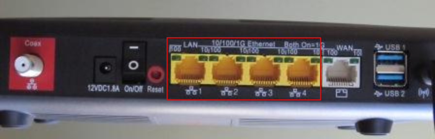

Before I continue down this road... I am not using my G1100 as my main router. I have my Netgear plugged into the ONT, and the G1100 into my Netgear. I did this to keep all my devices in my house on the Netgear and retain all my port forwarding, wireless setup, etc. I always believed this was an acceptable setup as long as the guide & on-demand work (which they do). Youtube app also works. Is this setup why my Netflix doesn't work?
- Mark as New
- Bookmark
- Subscribe
- Mute
- Subscribe to RSS Feed
- Permalink
Your setup is valid actually, it should not cause issues (well at least your setup is the same one described in the pinned topic on how to use your own router).
WIth your particular setup, I don't suspect that your issue is going to be there, but more likely the STB itself in this case.
If you are curious if you may see a different in behavior, I would definately suggest see how everything works when it's only the Verizon router in place.
Don't forget the break the lease on your router, then I would recommend doing a factory reset with the Verizon router, followed by the reboot of the STBs (VMS first, then IPC).
In your cause, I actually highly encouraging you to switch to using only the Verizon router when going though the previous steps, then afterward if the Netflix widget works, restoring your configuration and see if it continues to work.
