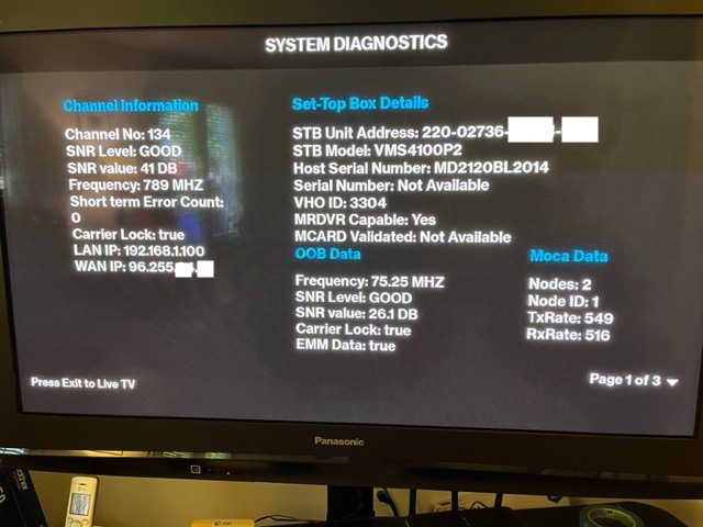

There are a few posts in the forum from folks with this error where it was intermittent or solved by rebooting. I have had several days of no guide at all (with the "Error Launching Guide" error) after many years of no problems. I've tried unplugging the ONT, router, MoCA bridge, and STB all at the same time and reconnecting a couple of times with no change. This is new in the last two days but consistently off.

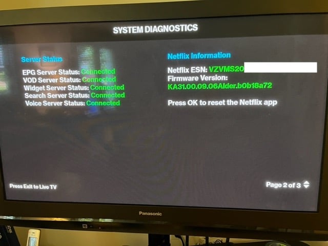

I have a tp-link Archer A10 router, Actiontec ECB6200 MoCA bridge, and the Arris 4100 STB. The diagnostic messages (attached below) seem normal to me (except the ZIP code). I blanked out the WAN IP, but it's correct. Also, in the Menu, the Sports Guide and On-Demand have show tiles that appear correct.
Any thoughts? Is there something in the diagnostic messages that I'm interpreting incorrectly that indicates one of those components went out? Thanks in advance.
