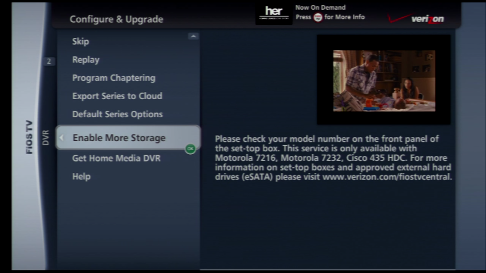

So I wanted to thank the forums for your help and insight on other users experience with upgrading the multi-room DVR's. I wanted to post some feedback because most of the reviews were focused on the newer cisco multi-room dvr boxes but not necessarily the motorola QIP7232-P2 with IMG1.9.1 software loaded. I tested several external hard drive solutions. I am one of those people who want the most drive space i can get.

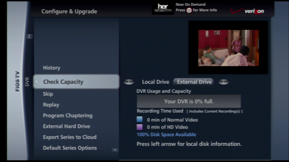

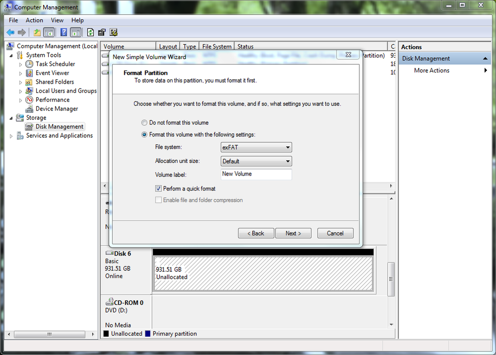

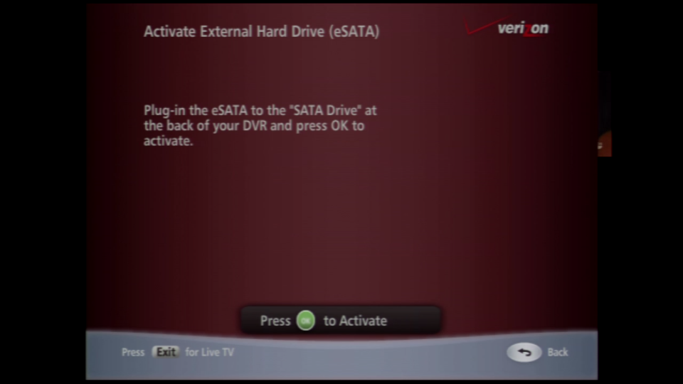

During the first upgrade attempt, the dvr did recognize the drive as being attached but after several reboots, attempts to run the activation utility etc the DVR would not let you access or format the drive. So this option is out and besides the DVR for sure wont use any drive over 3TB i confirmed this with my testing.
Second Upgrade Attempt
1. Western Digital 2TB WD20EURS 24/7 AV drive. - http://www.amazon.com/WD-AV-GP-TB-Hard-Drive/dp/B0042AG9V8/ref=sr_1_1?ie=UTF8&qid=1359839957&sr=8-1&keywords=wd-gp-av
2. Vantec NexStar 3 Super Speed External Drive Enclosure - http://www.vantecusa.com/en/product/view_detail/479

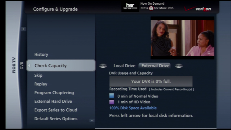

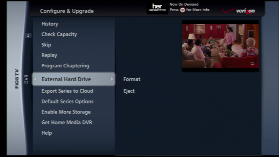

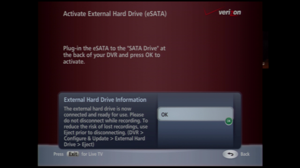

As soon as I plugged the drive in, the system found the drive and formatted it. No problems, it started working immediately and shows I have tons of space available now. This is working and I have tested for several days, no lagging, no video clipping etc.
