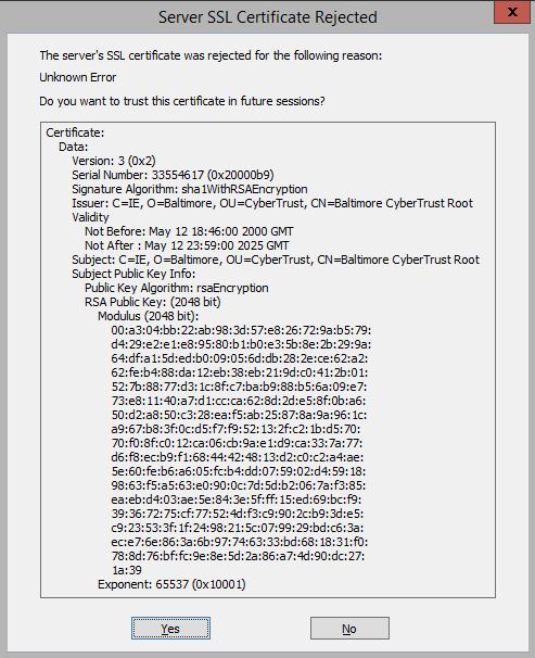

For the record, here is the error message generated by Eudora:
The server’s SSL certificate was rejected for the following reason:
Certficate Error: Unknown and unprovided root certificate.
Do you want to trust the certificate in future sessions?
Certificate:
Data:
Version: 3 (0x2)
Serial Number: 33554617 (0x20000b9)
Signature Algorithm: sha1WithRSAEncryption
Issuer: C=IE, O=Baltimore, OU=CyberTrust, CN=Baltimore CyberTrust Root
Validity
Not Before: May 12 18:46:00 2000 GMT
Not After : May 12 23:59:00 2025 GMT
Subject: C=IE, O=Baltimore, OU=CyberTrust, CN=Baltimore CyberTrust Root
Subject Public Key Info:
Public Key Algorithm: rsaEncryption
RSA Public Key: (2048 bit)
This was followed by the Pubic Key (in Hex) and Yes/No buttons to trust the certificate
After consultation with another forum, I clicked Yes and the e-mail was sent successfully.
There were no subsequent certificate errors and no further action was needed.

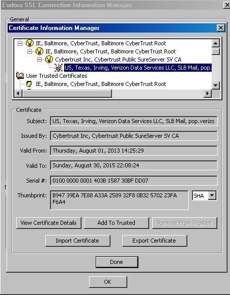

I had the same problem using Eudora 7.1.0.9 starting 2 days ago. No changes made except for a Windows udpate. I also run the free version of Avast. My error message referred to the Avast certificate being no good. I disabled scanning outgoing mail from Avast, but then got an error message same as referenced above. To further complicate matters, I have personalities set up in Eudora that allow me to send through Verizon, but receive through a different ISP.
I changed the Avast settings to again allow scanning of outgoing mail. I then went to the properties of my sending personality, clicked on last SSL info and then on Certificate Information Manager. At the top was a certificate generated by Avast with a "+" sign next to it. Clicking on that, I continued to follow the list down to the bottom where there was a Verizon certificate with what looked like a little skull and crossbones next to it. I highlighted that and told Eudora to accept it and all is currently well. We will see if it lasts.
- Mark as New
- Bookmark
- Subscribe
- Mute
- Subscribe to RSS Feed
- Permalink
@VanessaS wrote:I then went to the properties of my sending personality, clicked on last SSL info and then on Certificate Information Manager.
Hot dog! The Certificate Manager worked, even though it took two tries, first for one from the Netherlands and then one from Irving, Texas. Thanks.

I'm now in the same boat... my version of Eudora is showing the same certificate problem as yours, also from the Irving, TX location. I have tried the various solutions people have offered on the web forums, but without luck. I have right-clicked the dominant personality, opened Properties, selected Incoming Mail, and Last SSL. Every time, I have the same skull-and-crossbones on the last certificate in the list under Cybertrust (which is actually owned by Verizon), and no matter how many times I tell it to Add to Trusted, it doesn't.
Any other suggestions (other than using a different email client)? Is there a way outside of Eudora to import an updated, valid certificate?
Thanks for any advice you can offer. I'm going nuts here.
UPDATE: Okay, I decided to have one more whack at it, and sure enough, I had to "crawl" from the top icon (a smiley face) all the way down to the bottom (the skull and crossbones), going through the same miserable steps at each level.
- right-click the Dominant Personality.
- click Properties.
- select the Incoming Mail tab.
- click Last SSL button.
- open the Certificate Manager.
- open the smiley face icon tree until you get to the skull and crossbones.
- select the top one (and when you repeat this list, select the next, and the next, and so on, until you get to the bottom).
- click Add to Trusted.
- Click Done (this closes the Certificate Manager).
- Close the Personality box.
- send a test mail (it will fail until all the nodes are trusted).
- repeat steps 1-11 until you finally add the skull and crossbones line to the Trusted list.
Your mileage may vary, but I was shocked when I could finally send/receive email again using Eudora.

I am able to RX mail by trusting the new certificates in the Certificate Manager. These are associated with the pop.verizon.net certificate.
Sending mail is still broken as the SSL negotiation fails and the certificate will not update. This is associated with the smtp.verizon.net certificate.
I also tried renaming my Eudora usercerts.p7b file (manages SSL certificates) and building a new one with the same results. smtp.verizon.net will not update????

- Doing the steps as above has only restored incoming mail; still can't send
remember, there is a different certificate for sending and checking. I had to "add to trusted" the skull in "tools > options" for both "checking mail" and "sending mail"

I was actully able to import a certif from another Eudora I had that expired 2017. Then, simply clicking on the skull and "add to trusted" worked.
The backwards red "L" thru the skull in my pic above abviously means the certif was rejected AND has expired. If there is no backwards red "L" on the skull, then it looks like a normal rejection and "add to trusted" will work.
I guess my only question now is, what do I do in 2017.....How do you get updated certificates?
