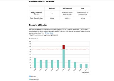

Example of my neighbors crashing my extender.

This is an experiment where I shut off my phone for a day, and this shows several hours and all the voice traffic going through my network extender is from non-members neighbors and they managed to exceed the threshold of the Network Extender. If I had been on a call when this happened, my call quality would suffer. This is why I need closed mode to work.
Also this graph is misleading because this only reflected what happened at the hour mark, it could spike higher any time between 00 to 60 minutes and this peaking activity would not show up in the graphs. In other works, the graph is not an actual reflection of all of the peak traffic or an average, a line graph with a one minute sample rate would be much more accurate. And should be available.
