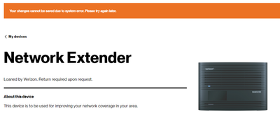

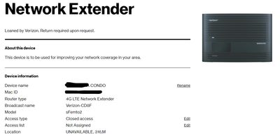

I have a network extender from Verizon and it shows up under My Devices. I used it in a condo my wife used to own in Las Vegas for several years and at one time it worked (even though I did have an issue with it being in Open mode). I ended up moving her to Michigan and have poor signal at the new place here too. I booted it up and it went through connections fine but it is in Closed mode.
I am not able to change it out of Closed mode as I get the error "Your changes cannot be saved due to system error. Please try again later."

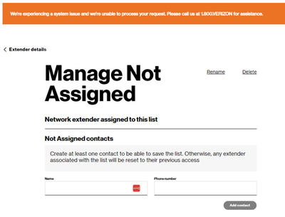

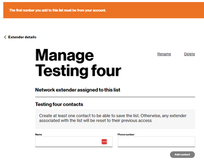

I am also unable to add any contacts in order to create an access list:
Hybrid Mode option seems to try and create an access list (I named it "Testing four" here) but it does not recognize any number I put in (I have 9 numbers on my account).

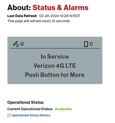

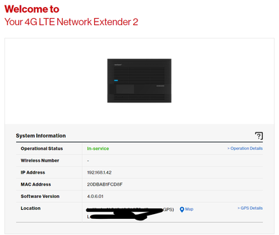

I can access the webpage just fine and it seems in working order

Also, I am not able to delete out the default empty access list. It states if I do this then it will revert to Open Mode but I get an error when I press delete.

No, the extender indicates that no phones are utilizing it even though the status page says the extender is functioning. When I dial #48 I get the recorded message "You're not under extender network coverage. Please move closer..." even though I am right next to the extender. The screenshot in my first message indicates zero connections and that it is in closed mode. I am able to start a whitelist in Hybrid mode but am unable to add any phone numbers from my account, including my own. I am also unable to create a whitelist for closed mode at all as shown in the screenshots. The Verizon webpage keeps stating there is an error when I try

Interesting development. Just got an error message that I have not seen before when I tried putting my wife's number in: " It looks like you’re using an older SIM card that’s not compatible with this network extender. " You can replace it with a new SIM card to connect. Do you have directions for how to change out the SIM card?
What is also interesting is that is the only number out of the 9 on my account that gives the error message about replacing the SIM card. The rest state that there is an error and to call Verizon.

The model number is SLS-BU10B.

Yep it is working. Shows zero connections. Model is SLS-BU10B
