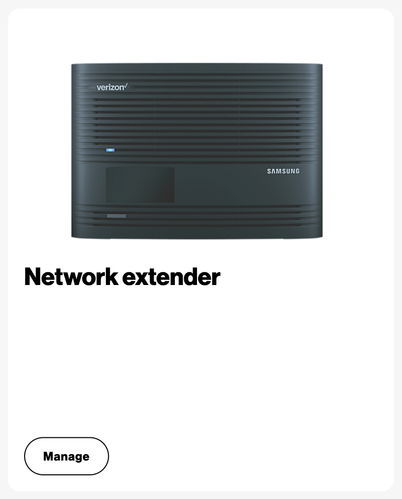

After a day of my own searching, I was finally able to figure out that Verizon offers a Closed mode to prevent everyone in the neighborhood from taking over your private internet connection. This is the most error prone, poorly designed device I have ever used in my life.
Unfortunately, the button on their website sends you to a broken URL with a server name that doesn't exist. I don't know if this is temporary or not, but when I do try to click Manage to access these settings, I end up with an error that "myvpostpay-gz-walb.verizon.com’s DNS address could not be found".

With all due respect, this is a boilerplate answer that does not address my question very well.
My issue with with the My Verizon website, where I am unable to manage my LTE Network Extender. I do not think there are any problems with the device itself, or at least there will not be once I can go into My Verizon and put the device into Closed mode.
I do not want it to operate in Open mode - that's not acceptable to me. I do not want to open up my home internet service to the world, and I am not funding backhaul for Verizon just because our neighborhood has poor coverage.
The problem needs to be fixed somewhere in the My Verizon management interface (i.e. the website). I have no idea how to get that deep into the machine to make them fix this, but it's totally broken right now.

Nothing is labeled as a "model number" from what I can see. It's a Verizon branded LTE Network Extender (despite the fact that the image on the website is for a Samsung device... sigh). This is what is on the label for mine.
SKU: ASK-SFE116
Date Code: 20230926
On the device's management page, the SW version is GA5.14 V0.5.014.1657.
